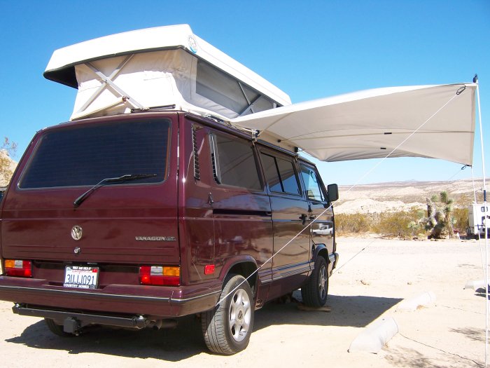

Angelo F.
QUOTE (Jonathan Sojourner @ Mar 11 2008, 07:25 AM) *
See...I like that idea. Especially seeing a head sticking up wearing a pair of groucho glasses like yours. slap.gif
While it might be a little cost prohibitive cannibalizing a split westy for its' pop up section, you might want to consider a Vanagon Country Homes model f/g pop section to retrofit. They're a lot easier to find in the scrapyards, and as long as the fiberglass and pop up mechanism are solid, the canvas and screen should be the easy part if they need repair/replacement. All things considered, it should be a relatively straightforward project.
http://www.countryhomescampers.com/graphic...d%20_Awning.jpg

QUOTE (Angelo F. @ Mar 11 2008, 07:55 AM) *
That one has basically the same poptop as the Campster, just bigger. I don't think it would be terribly hard to duplicate a Campster poptop. The hardest part is making the two pieces fit water tight when closed, I think.
