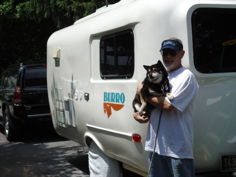

My "little Captain" and I admire our shinola job on the port side of el Gordo. Four coats of Red Max on the port side; three looked even, reflective, adequate. Calm and overcast day; really the worst threat to a perfect finish was particles of dirt and bark from the Norwegian spruce in bkgrnd. Also many I-seeums-just-fine which aspired to the status of flies in amber. Have to take the larger view that the wax is a cosmetic improvement and dirt shedder and a few embedded bugs don't matter much to those passing at 85mph!
I have a section of scaffold set up which helped with the initial Barkeeper's scrubdown. A painter's extension pole and a bonified Polyglow applicator and a ladder was all that was needed for the ap (altho I did climb out on the central roof to cut in the first coat with the smaller chamois included with the Polyglow mop. The bifurcation by vertical seam inclines one to do the job by halves so now it's on to the right side. I'm closing in on a presentable rig for the Delaware Water Gap rendezvous next month but still quite a bit to do evenings and weekends.
jack (the old dog with the little dog)

. . . and another with the sun in a better position this evening:

If contemplating the plunge to floor wax, look back at Randy Bishop's pic of the Polyglow applicator in a very early post on this thread. It isn't cheap at 15$ but I'd say it's worth the cost to apply a very even coating. Polyglow recommends that it be washed out in water (and I used some Dawn liquid detergent), wrung out, and bagged airtight until it comes into play again for that annual recoat. I bagged mine and put it in the fridge; I hope it doesn't develop mold.
I like the slight "bronzy" color cast of the wax as against chalk white oxidized gel coat. Also seems to have made gel coat repairs and, dare I say it, expedient rattle can coverups disappear.
