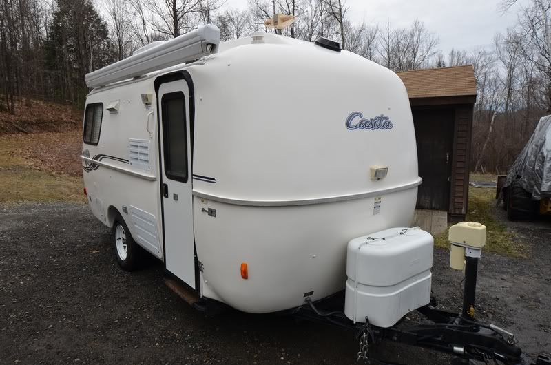

So we decided to try the floor finish on our new to us Casita. Some of you may have seen this bug shot taken after 1750 miles on the road. They did not come off easily; it took a lot of scrubbing. I do believe a good polish and wax would have brought the finish right back, but that also requires more frequent upkeep than what we are hearing about RM/Zep. Our local stores have made the swap to Zep, so that is what we used,
[/IMG]
This is after cleaning.
[/IMG]
And this is after 5-6 coats of Zep. Today was the first time we took it out in the sun since I did it last week. It looks great. The finish feels a bit "stippled", I think due to the rags I used. I did get new microfiber, but I think I should have washed them first. Still, if the bugs wipe off as I've read about, we will be very happy.
