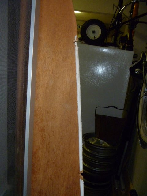

I'm installing new cork laminate flooring in my '91 16' Scamp and when I pulled out the screen door fame I noticed this.
The body is pulling away from the front bench frame. I had noticed that my luan board that makes up the front part of the door frame had ripped away from the ledger that it screws in to but I didn't think it was this bad.
The above piece screws in to the glassed in tab/ledger in the picture below.
I'm guessing I need to cut a new piece of luan to match the new radius. I had thought about trying to use a winch to bring the two sides together a bit and then using some stronger plywood in the door frame to try and maintain the curve but I just don't see that being strong enough to hold that much stress. I'm guessing this is pretty common in these older trailers and nothing to fret about?

When I made the screen door, I used 3/4 pine for the door frame and the door casing. I drilled and screwed through the fiberglass frame into the casing and covered them with the rubber seal. There was no reinforcing metal piece behind the hinge side and this removed the bulge and stiffened the side up considerably. On the latch side I fastened the framework from inside the closet and also through the frame edge as on the other side. Haven't had a problem since I installed it about 6 years ago. I dont think this would have worked using plywood as screws into the edge don't hold very well. If you are going to make a new piece then I would suggest that you use some kind of solid wood.

Well, it seems like the best option might just be to live with this as it is and cut a new piece of wood for the door frame to match the current radius. James, I like your idea but it seems like it might be more work than I feel like doing right now! I don't even know how I'd get that side to "go back" to its former shape anyway. At least I know I'm not alone!

I have the same problem but I can push it back in place fairly easily from the outside. I think I will try a small turnbuckle and cable fastened to the ledger in a couple places with a metal bracket and the other end to the floor. It will be hidden underneath the bench but it won't be depending on the bench for support.

Bryan, have you judiciously checked the frame for breaks or cracks? Typically when the body bulges one of three things is going on... either unsupported weight on the roof (A/C on a trailer not built for the weight), cracks in the frame (the body starts to spread) or the supports between the lower cabinetry and the upper cabinetry has been removed (because of asthetics). Are any of these three things occuring in your trailer?
Think of your trailer like a balloon. If the top of the balloon is pushed down, the sides bulge.... let us know how it goes.
