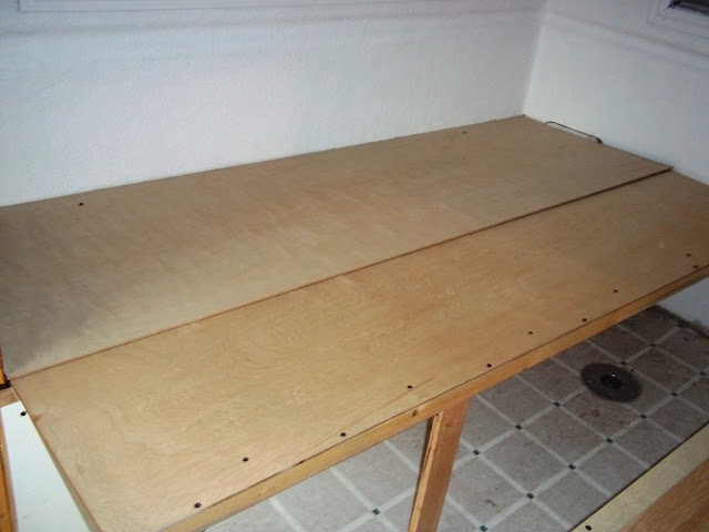

Pictures of the bed(s)/couch(s)
I still need a few legs, but you get the point.

I like the bed though I am thinking of making it permanent at about 28 inches with a walk between space. Something I can buy cot mattresses for, anyway. If I do it. I realized the way I have it now is pretty much like a V Berth on a boat but with more foot space so we could still use it to sleep two and be able to get in and out okay. Mine is also for taking my mom along but we have to share the space.
I wonder how it would work to put in one cot and then have a fold out bed for the other side? Hm, I need to think about that. I would have more space without her and could still add a bed when she came along.

Bobbie, each of the couches are about 22", leaving a 26" space in between. Each then has a slide-out that will reach a maximum of 14" for a 36" space for each single bed or they can fill in the entire walk-way to make one large bed.
My van has a 26" couch that slides out to a 42" wide bed and it will sleep two *married* people. I scaled the trailer beds down a notch since there would be two and no need to double-up on either.
We also discussed leaving one bed out and just having a cot available. We assume that most of the time there would only be a single person sleeping in the trailer. For now we stuck with two beds/couches, but it one can be removed with less than a dozen screws once we know the number of people on the trip. If we knew that there would only ever be a single sleeper, we would leave it out and install some additional counter-space and storage instead. I will probably build that so we can pop either in (or out) before each trip depending on how we want to roll.

If you have a moment I have a couple questions. 1). Did you attach the bed/couch to the fiberglass lip it rests on? 2). What kind of sander did you use for the bondo?

Yes, I used the existing wood which was still in good shape. If that failed, I would have put a simple horizontal piece in supported by a few legs, attached to the wall and floor as needed.
