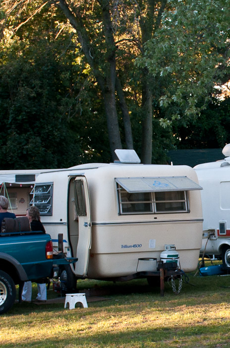

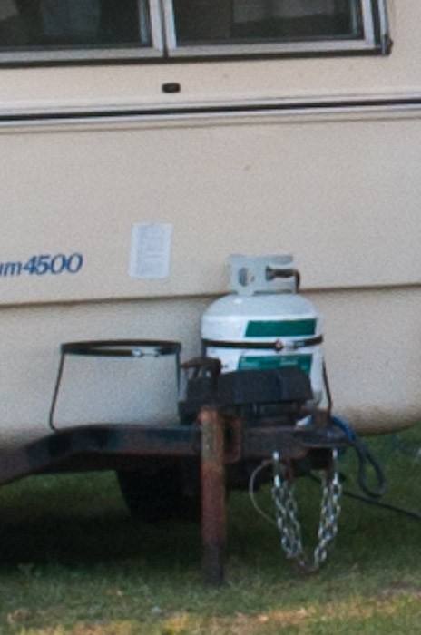

I found a picture from those posted on the Niagara 2010 meet. You can see the front of my Trillium 4500 to the right of the green pickup. The curbside tank is off being used, but you can see the second tank for the trailer and the battery box.
http://www.lakeshoreimages.com/images68/SUE_5169.jpg
Maybe if Jon has the original, he can crop in on that area and post it? Or Jon does say he will email the photo's to anyone if they ask.

Here is a couple of crops of the tongue:

Excellent. That is exactly what I was looking for.Thanks
