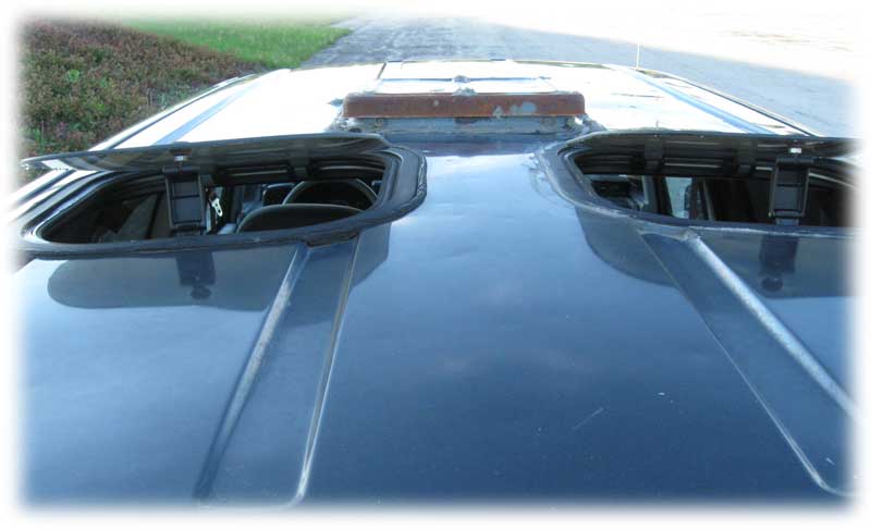

p.s: a quick Google search uncovered this picture of two square sunroofs that someone had installed in a van, something similar might be just the ticket!

Old 06-12-2016, 02:09 PM   #33
David B.'s Avatar

They are called His and Hers Sunroofs. Several sellers on Ebay, this one is a well known company.
CRL SFC 17 x 17 His 'N Hers Sunroof with Universal Trim Ring High | eBay

Thanks for the link KC! Those are pretty cool, the only thing that concerns me a little bit is how much I'd need to modify it to fit the really thin fiberglass shell...? Something I'll ponder.
