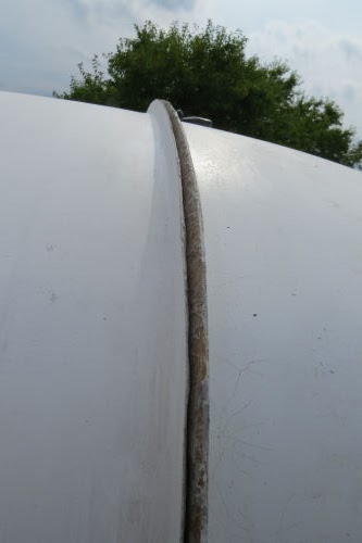

The seam where the two halves of the trailer join has been sealed at least 3 times, two with silicone and one with butyl. Most of it is cracking and separating. In other words, no longer a watertight seal. I'm chipping the loose stuff out. Assume that the correct sealant is butyl. (And I have new trim loc to put over it after painting) Right?

If it were me, after thoroughly cleaning out all the old silicone and calking (there is a product to dissolve silicone), I would fiberglass the seam of the two halves together. I would leave the original look by not cutting off the seam, and still cover it afterwords with a new trimlock covering.

Dave- thanks for your input. I have also had this question out on the U-Haul camper group on FB, and I think I'm settled on an answer. I'm cleaning all the old gunk out (going pretty well- it's so old it's quite loose), and then I will do a bead of 3M Marine 5200 Adhesive/Sealant, and then add the new Trim-Loc after painting. Unless someone hits me with a really fantastic better idea, this is it.
Clearly, everyone thinks that it needs something to help hold the halves together other than the interior fiberglassing. And, as I said over there, I wasn't sure what was holding the trailer together. (Just that interior layer!)
