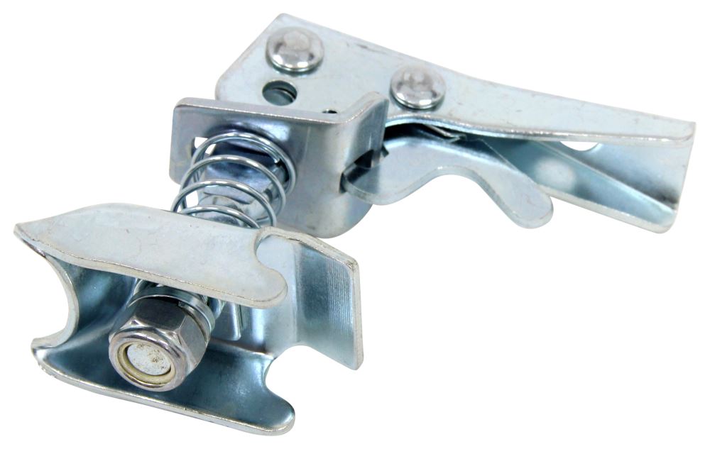

The latch on a standard coupler can catch on the top of the ball when attaching and still close, appearing to be latched.
You must check that the latch clears the ball and drops below it before closing.
The latch on the coupler is also adjustable and should be checked for correct grip. There is a nut which can be accessed from under the coupler.
Grease won't affect the security of a properly adjusted and installed Coupler.
Odds are that your latch just did not grasp the ball but still allowed the lever to close.
Glad everything worked out.
If worn or bent, there is a rebuild kit available which includes the lever, shaft, spring and latch
