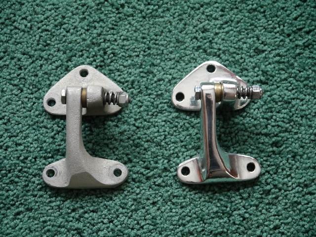

Polishing all the aluminum on my Boler continues. This keeps me occupied during these cold snowy days.
Thought members might like to see what can be done with a standard Scamp door hinge by doing a little sanding, filing and buffing. Thank goodness there are only 2 door hinges.
Here they are side by side one before and one after polishing

Old 02-15-2014, 12:44 PM   #191
Rick Mooyman's Avatar
Trailer: 1971 Boler (SOLD)
Posts: 999
WOW that is AWESOME. Someone has a lot of time on his hands LOL

Need to post another picture a couple months from now to see how it holds up. Are you going to apply some sort of protectant?

I won't use any protectant because that actually decreases the shine, and I am not worried about the parts tarnishing. I have a lot of polished aluminum on my car's engine and it takes very little to maintain it. The key is to polish it properly, this leaves a very slick surface with a thin wax film. Then annually a light touch-up with a cloth and some Autosol which leaves that thin film of wax and very shiny aluminum.

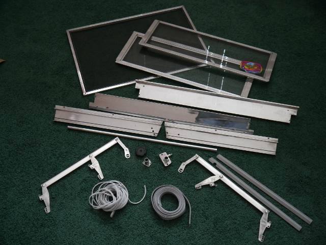

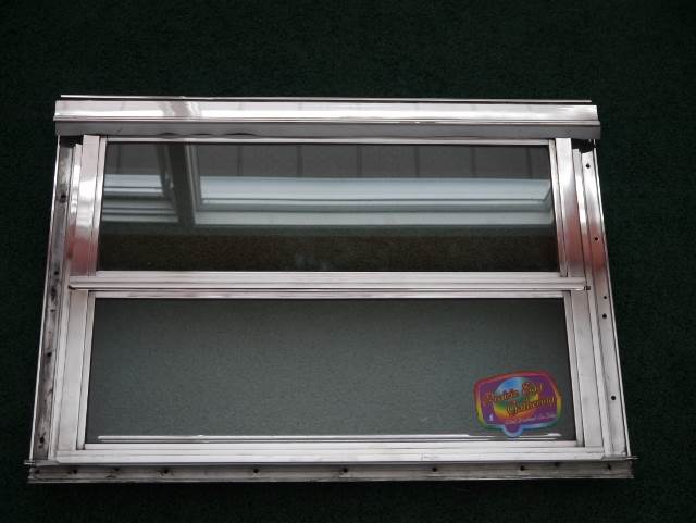

The new top, side and lip seals and gaskets arrived for the Boler side windows so I was able to reassemble the first one today. I completely disassembled the windows to polish them.

I got the seals through Vintage Trailer Supply
The side and sill gaskets were Part #VTS-526 Jalousie J-Seal
The top gasket Part #VTS-386 Jalousie Header & Sill Seal
Vintage Trailer Supply - parts and supplies for vintage travel trailers and campers!
When replacing the side and sill seals DO NOT slide them into the slots, the seals will stretch and when they relax they will be too short. Instead you can insert the upper tab and work the lower tab in with your finger nail, work very good.
Another tip is you might have noticed I have a round knob to open the window rather than the standard crank handle. I found the original Boler cranks cumbersome, got in the way of the window blinds and would "stab" me in the back when I sat down. The round knobs from roof vents that can be purchased from any RV store have the same spline and fit the Boler windows perfectly.
