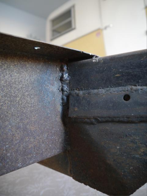

Adding to the work I noticed that something just didn’t look quite right with the frame so why not take the fibreglass egg off the frame to inspect it a bit closer, am I ever glad I did.
The original frame was not in good shape, from the Boler factory most of the cross members were only welded on the sides not the top or bottoms,
the remaining welds were very poor quality. The light metal of the frame had broken at one time and had a reinforced repair, the main left frame rail was bent and cracked at the axle and all of the mounting bolts and screws were either pulled out or loose.

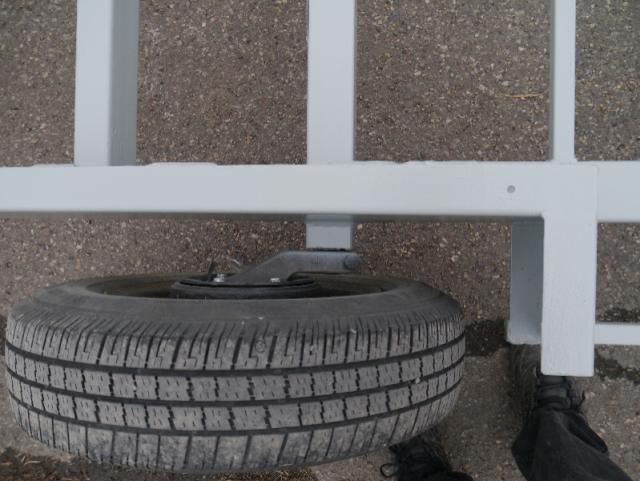

A new frame had to be built, reading many of the posts on this site I decided to make the frame considerably stronger and install a new FlexiRide axle with brakes in a trailing arm configuration. The design of the new frame is radically different than anything I have seen on the internet, being as the frame needs a dropped section which means cutting the right frame rail I wanted to ensure strength was not compromised. The new frame consists of custom bent 2”x6” “C” channel made from 1/8” or 0.125” steel, the original frame was 1.5”x3” 0.0625” or 16 ga rectangular tube.
Cross members in the new frame are 2”x3”x0.125” rectangular tube with boxing added to the frame in critical areas. Now I know many of you are thinking “how much does this frame weigh?” The original Boler frame with axle (no brakes) and tires weighed 300 pounds, the new frame with a 2000 pound axle with brakes, and the same tires weights 395 pounds. The brakes alone account for about half the additional weight and the strength of the new frame is considerably more.

New frame rails set on original frame
Close up of 2"x6"x1/8" frame rail
Welding frame
Sandblasing new frame
Ian G. is offline   Reply With Quote

Now the new frame is ready for painting.
A coat of epoxy primer is followed by 2 coats of 2 part polyurethane
The FlexiRide 2000 pound axle is also installed

That is quite a frame. You obviously have some skills. What axle capacity did you select?

It is a 2000 lb Flexi-Ride axle with the trailing arms set at 10 deg up.
The Boler rides just over 1" higher than the original frame sitting on the original worn out Ingersole Rub-R-Ride axle

Originally Posted by David Tilston View Post
That is quite a frame. You obviously have some skills. .........
Yea, from the vertical section, I'd say it is good for about 20,000 pounds.
LOL yup that is what I thought too
Considering I needed a 6" drop in the floor to accomodate the step floorpan and axle location this design was the strongest, lightest and easiest to fabricate. I told my wife that if she ever wants a 32" trailer we have the frame for it.
