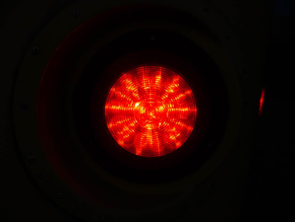

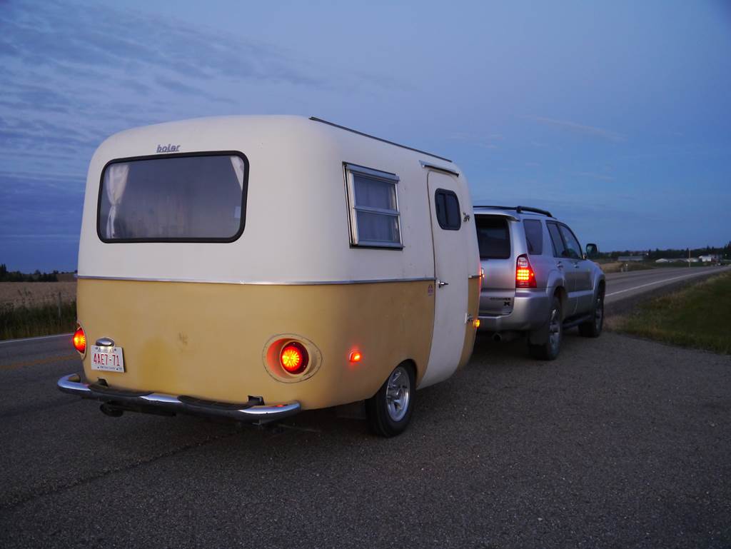

Posts: 1,380
As another option 4" LED taillights will fit right inside the original Boler "Hat" lens. I installed these in mine and used silicon to seal them into the lens.
They are very bright, this is what they look like.
