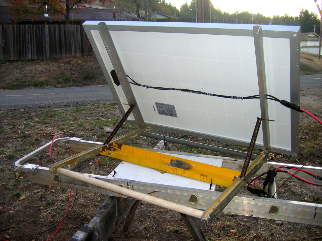

I like the idea of charging the battery while traveling and of being able to move the panel into the sun when camping. For that reason I'm considering mounting the panel on the roof of the TV, a Subaru Forester in our case, and being able to remove it for better directional placement when camped.
Anyone have suggestions/experience with this?

This is how we use my panel set up. Just slip the aluminum ladder mounted panels up on the roof rack of the Jeep, secure it down, plug in the MC4 connectors to the trailer and you are on your way. It charges while driving down the road independent of the TV's electrical system. We took it out on our first 3 day adventure just before Thanksgiving and it worked flawlessly.
The panels are light enough that they are easy to handle by myself when the panels are laid down flat. Since this picture was taken, I added some small 6' diameter plastic wheels from an old lawn mower to one end so that it will roll when on the ground.
The panels can be raised on the frame, either for or aft on the frame (dependent on which way the TV is parked) or rotate about 80 degrees on the frame.

Looks like a very practical setup, well done !
How much does the whole rig weigh ?
I have a 190 W panel on the roof of my Escape 17B, so far that's been enough. I thought if I needed more I'd add a panel to the roof racks of my TV similar to your setup.
Thanks for posting the pictures.

Bob, I haven't put it on a scale so can't say how much it weighs. Most important to me is that I can easily press one end of it up to the edge of my roof rack and then go around to the other end and push it up as well. Except for the yellow colored cross beam across the base, it is pretty much all aluminum. The yellow beam is a 10ga. steel channel made from a pair of old fold up saw horses and the two pieces of 1" PVC pipe paralleling the yellow channel held in place by 5/16" all thread stock. The hinge points are connected by 1/4" X 3" locking pins and 3/16" X 2" locking pins to hold the top of prop rods which are hardware store shelving tracks.
The whole tilting menagerie is probably unnecessary whenever the ladder is offloaded at camp since the whole frame could be propped up at an angle against a tree or a rock. But if it stays loaded on the roof rack of the Jeep it is nice because it doesn't matter which direction the jeep is parked. I can still point it directly at the sun while parked. Of course it lays flat while travelling.
