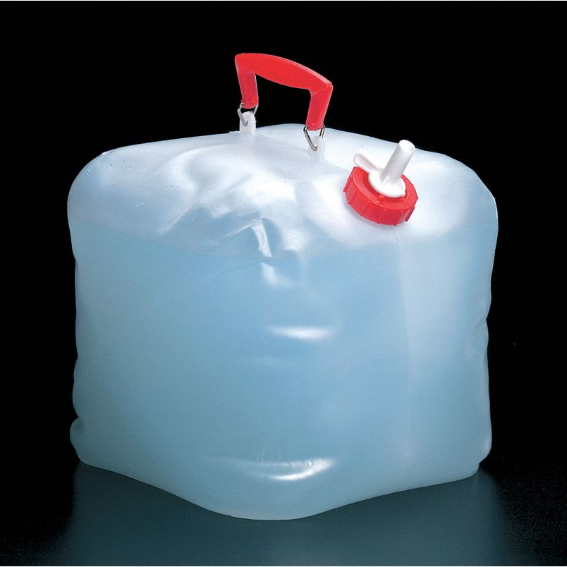

https://images-na.ssl-images-amazon....AC_SL1000_.jpg
google 5l collapsible water jug, something like this might work

2-1/2 gallon collapsible water jug

We've used a collapsible/foldable water carrier with a water filler spout on grey water catchment set-up for our `88 Westfalia's sink drain for 33+ years, & for our 1970 Eriba Puck since we got it in 2018 (with drain size angle adapter), and the same would work for your Casita.
While GoWesty doesn't list the collapsible containers right now, they're readily available at all camping outlets, online (Amazon as noted above), Walmart, etc.
Water Filler Spout for insertion into the container - clearly mark as "Grey Water" if you use them to also fill your fresh water tank:
https://www.gowesty.com/product/fauc...ler-nozzle-?v=

Another example of a collapsible container:
https://www.basspro.com/shop/en/fold...E&gclsrc=aw.ds
The above adapters & fillers are probably also available elsewhere wherever camper & camping supplies are sold.
